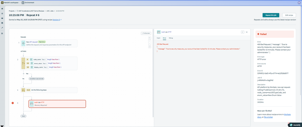

  • In my main orchestrator recipe, I intentionally throw an error to simulate failure. This correctly triggers the error handler recipe via Call recipe.
  • The error handler logs the error and then conditionally triggers the job recovery sub-recipe based on a conditional block.
  • The conditional block came pre-configured from the AOF Academy package with a default value of "Yes" (under the condition to execute job recovery).
  • However, despite this setup, the job recovery recipe never executes — it doesn’t appear in the job dashboard at all.

🔍 What I’ve Verified:
  • The recovery recipe is active and callable.
  • The input/output schema between recipes is configured.
  • The condition in the error handler is present as per the Workato Academy template, with the value set to "Yes".
  • There are no error logs or failed job records related to the recovery recipe.
It seems like the recovery recipe is never invoked, even though all conditions are met.
Has anyone else encountered this issue while using the AOF package from Workato Academy? Any advice would be appreciated!

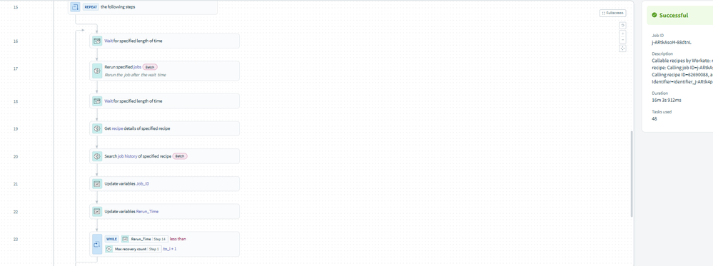

Root Cause
The main problem was within the Job Recovery recipe logic. Although the recipe was being called, it was not iterating or retrying as expected due to missing conditional handling and iteration logic.
🔧 Solution Implemented
To address this, I introduced the following enhancements using RecipeOps:
  • Added a WHILE loop to handle multiple recovery attempts (up to 5 retries)
  • Introduced a 60-second wait interval between each retry attempt
  • Defined and used conditional variables (Job_ID, Rerun_Time) to monitor and control each rerun cycle
  • Used Search job history of specified recipe and Rerun specified jobs actions inside the loop
This structure now ensures that the Job Recovery recipe retries failed jobs consistently within a defined timeframe.

Screenshot 2: Logic implementation inside the WHILE loop within the Job Recovery recipe
