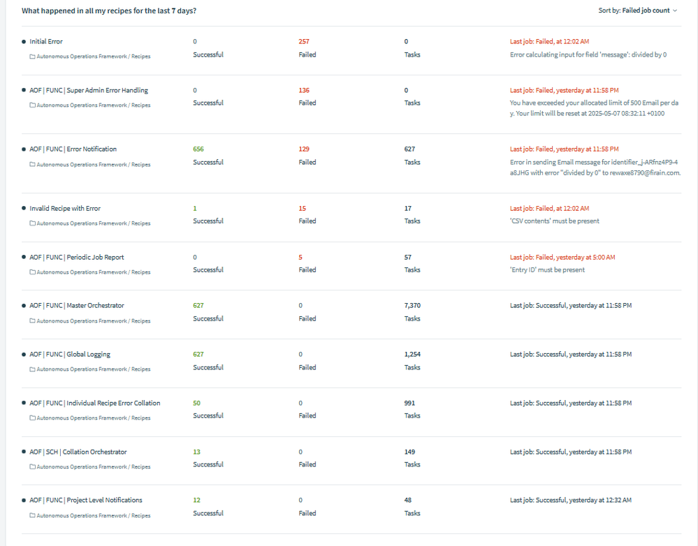

Image 1: Job dashboard showing no trace of the job recovery recipe being triggered.

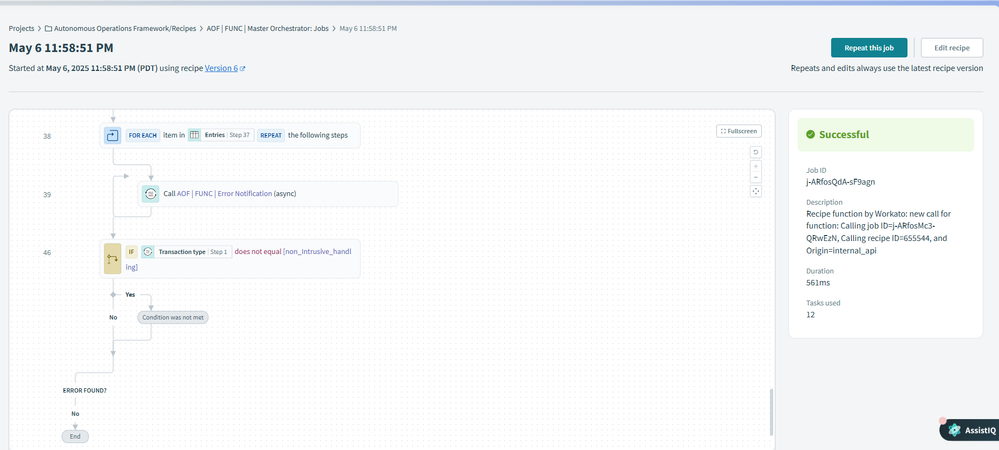

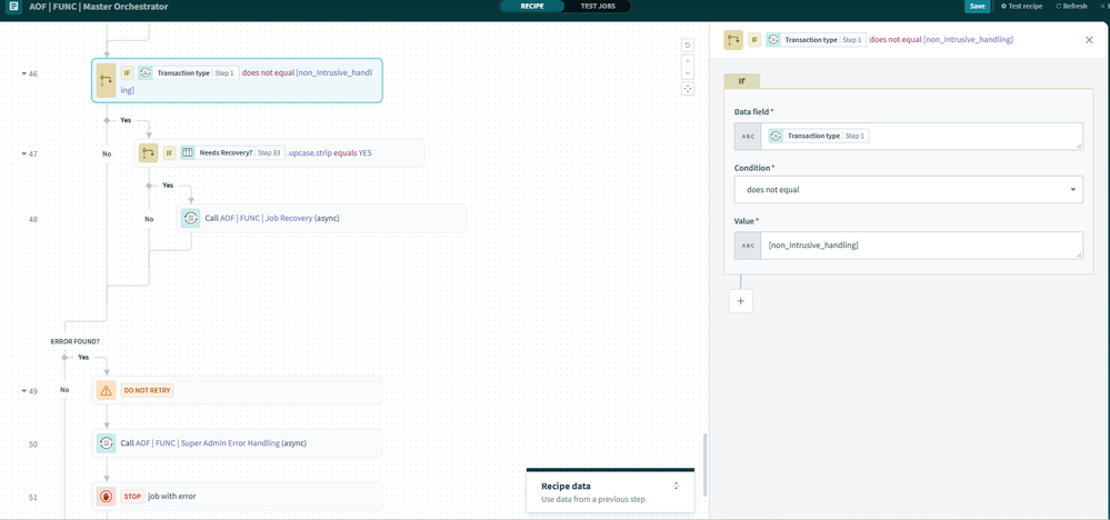

Image 2: Main orchestrator recipe where error handler and recovery recipe are referenced.
Image 3: Test execution confirming failure, but no recovery call was made.

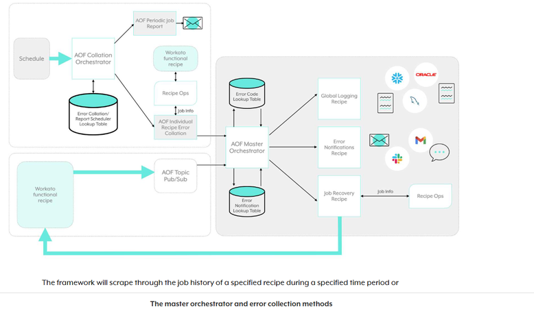

Image 4: My AOF flow diagram (intended full structure).

I’d like to update that the issue I faced with the AOF Job Recovery recipe not triggering properly has been successfully resolved.
✅ Root Cause
The main problem was within the Job Recovery recipe logic. Although the recipe was being called, it was not iterating or retrying as expected due to missing conditional handling and iteration logic.
🔧 Solution Implemented
To address this, I introduced the following enhancements using RecipeOps:
Added a WHILE loop to handle multiple recovery attempts (up to 5 retries)
Introduced a 60-second wait interval between each retry attempt
Defined and used conditional variables (Job_ID, Rerun_Time) to monitor and control each rerun cycle
Used Search job history of specified recipe and Rerun specified jobs actions inside the loop
This structure now ensures that the Job Recovery recipe retries failed jobs consistently within a defined timeframe.
