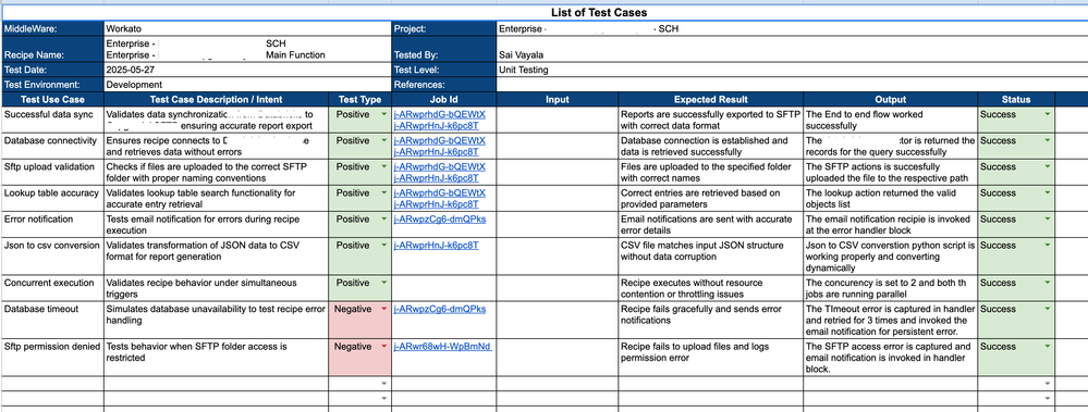

AI is the solution to most things :). If we integrate Workato code with AI, it opens up even more possibilities. I created a Slack bot that, after receiving project or recipe details from Slack, generates beautifully formatted technical design documentation for Confluence. It is saving many hours for my team.
We also developed another solution to generate test cases. By providing a recipe and a bit of context to the Slack bot, it automatically creates a spreadsheet with test cases.
This solution is perfect for those who don't have access to AI and want minimal manual intervention.
Like below sheet was create by that slack bot, i had to just fill the job id, output and status column
