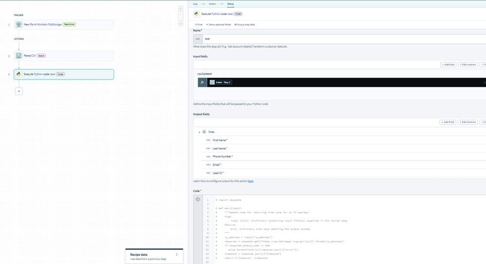

โ12-11-2025 07:30 AM
Hello @ecamarillo ,
Python in Workato works different
please check the commented part in the code block for the reference and also pass your input content in the input section of the python code and access it in below code block.
see below image for better understanding, the code should be written in Workato supported format.
Please let me know if you need further clarification

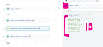

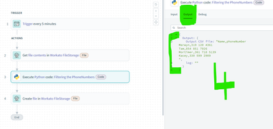

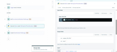

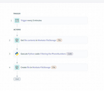

โ12-11-2025 10:32 AM - edited โ12-11-2025 10:53 AM
Hi @ecamarillo,
In workato, need to define python code in different way and also calling input data or values differently, here I am attaching the python code, recipe URL. you can easily check perform your filtering.
recipeURL: Cleaning PhoneNumbers from CSV File using Python code
import pandas as pd
import io
def main(input):
try:
# Read the CSV content directly from the field Workato sends
file_content = input['input_CSV_File']
# Convert CSV text to DataFrame
toread = io.StringIO(file_content)
df = pd.read_csv(toread)
# Convert phoneNumber to string
df['phoneNumber'] = df['phoneNumber'].astype(str)
# ๐ฅ Delete rows where phoneNumber starts with "1"
df = df[~df['phoneNumber'].str.startswith('1')]
# Convert back to CSV
updated_csv = df.to_csv(index=False, header=True)
return {
'output_CSV_File': updated_csv
except Exception as e:
return {
'error': str(e)
Further, if you have doubts, please keep posted, will discuss here.
