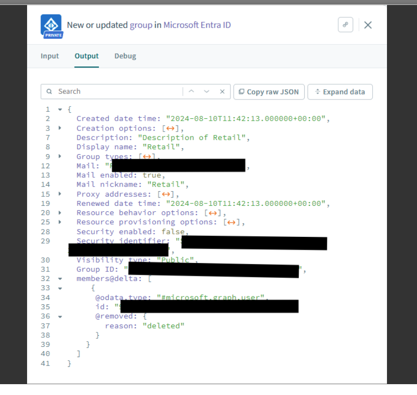

the trigger JSON output provides data on member@delta which I want to use in a next step, but the data is not visible in the datapill.
cheers, Jacques

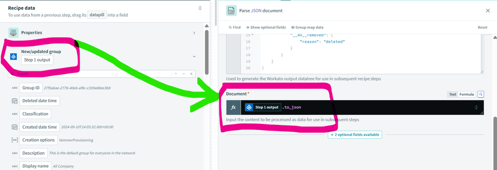

steps to follow:
1. first switch to formula mode of Document Filed
2. Map the step output pill, as shown in below image attached.
hope you got my point now??

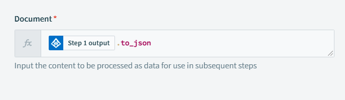

For that you need to do PARSE JSON by providing copy raw json data from step-1 output in sample document and in Document need to pass step-1 output pill.json (like below shown in image) then you can access each pill from Microsoft Entra ID.

click on Copy raw JSON and paste it in the sample document box and in document map the step-1 output pill as i mentioned above image, in the logger if you check, you can access the data pills of each field, hope you got my point?
