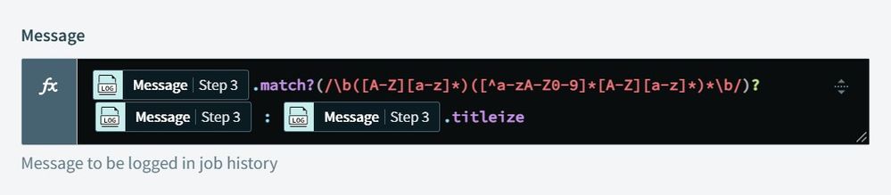

09-11-2025 11:56 AM
Hi @spencerstone
I think you can try this way

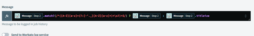

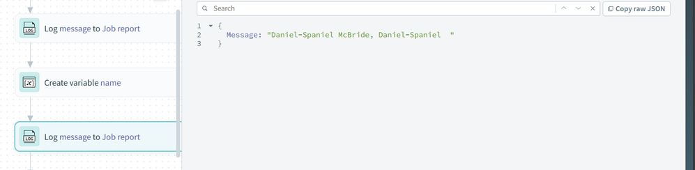

09-12-2025 09:23 PM - edited 09-12-2025 09:37 PM
Hi @spencerstone ,
Here is detailed solution to the asked requirements.
Example
