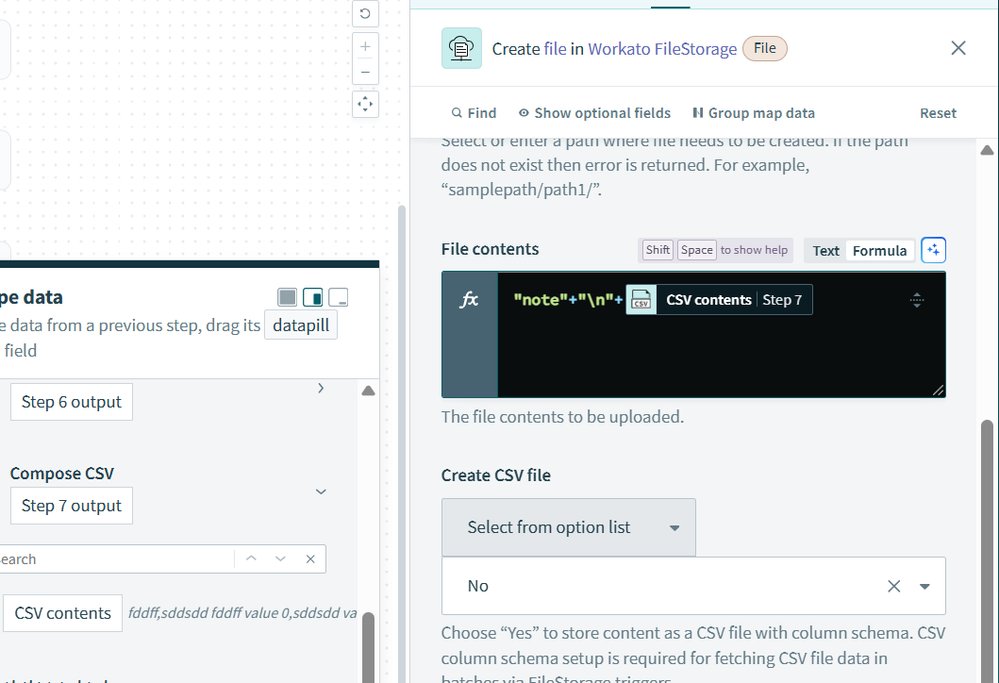

Hi  @DChandanaDevi
Workatoโ€™s CSV actions always assume the first row = header, so you canโ€™t directly insert a โ€œnoteโ€ row above it.
Workaround: Use formula mode to manually prepend your custom note line to the generated CSV string.Screenshot 2025-09-01 185800.png
