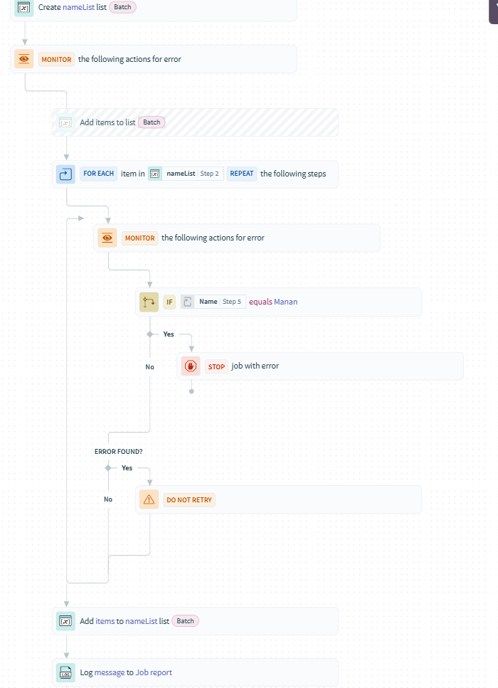

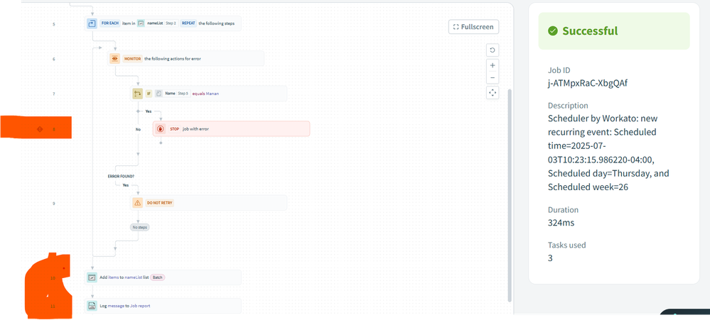

Hi @Rajesh_Nadella ,
To achieve the above requirement, here is the proposed solution:
Add a Monitor block inside the "For Each" loop:
Use this to validate each item. If a specific condition is met, stop the job by throwing an error. In the associated Error block, leave it empty (i.e., no action needed). or If need you can add logger/ slack notification
Place additional logic outside the "For Each" loop:
This ensures that any further processing continues only after the loop completes or is exited.
Advantage of using the Monitor block inside the loop:
It allows you to break out of the loop when a certain condition is met. However, note that this does not prevent the loop from continuing for other items unless the job is explicitly stopped.
Please let me if this helps;
