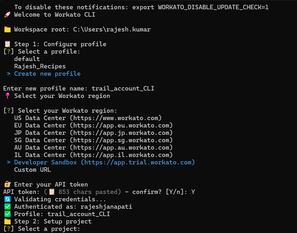

Hi @steverist ,
Before diving deeper into troubleshooting, I have one question: Have you selected the correct Workspace URL and generated the API Client token from that same workspace and also we should not use any prefix before the token like Bearer, just copy & paste the token from Workspace
A 401 Unauthorized error often occurs when there is a mismatch between the Workspace URL and the API Token being used. Please verify that:
It appears there may be a mismatch between the workspace and the Token being used. Please double-check these settings and try again.
For reference, I have attached a screenshot that illustrates the correct configuration.
