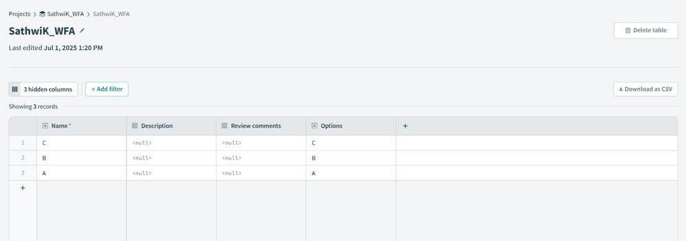

Let's Assume this is your data table "Sathwik_WFA"Screenshot 2025-07-01 132428.png
the options which you want to display in your Workflow App are A,B,C. What you can do is :

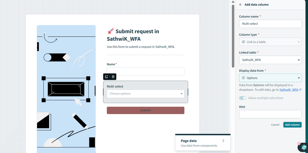

Scroll down on your left hand side and you will find "Choice" select "Multi-Select" and drag that to the page.

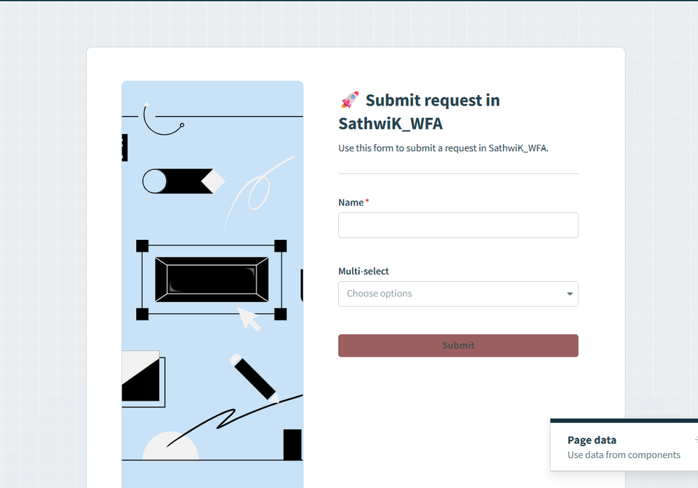

After that your workflow will look like this :

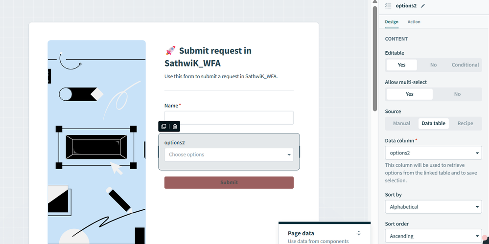

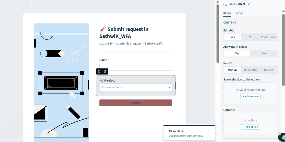

and when just click on that multiselect option you can see the features of that Multi select on Right Side .
By default the Source option will be selected for "Manual". You need to just select the option to "Data Table". Then It will show all the available data tables in your workspace, You need to just select the data table Name from which you need to get the data from and then select the Column from which you need to see the data in my example which is option column.
For Column name which you see as a mandatory fields you can enter any new name like I have given Options2

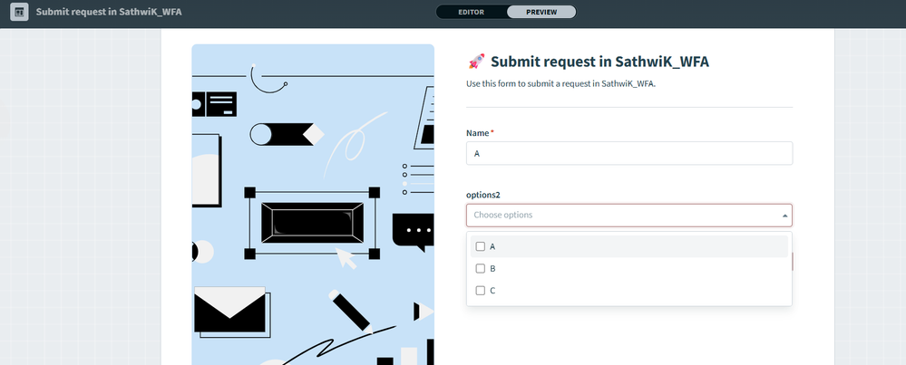

after this process just click on Preview which you can see on the top of the page to check whether our display of options works or not.
and Boom!!!!!!
Now you can see the options which are data table present in the Multi-Choice Set
Yes, This is the Detailed Solution. Please Let me know if this helped you or If You need any more help.
