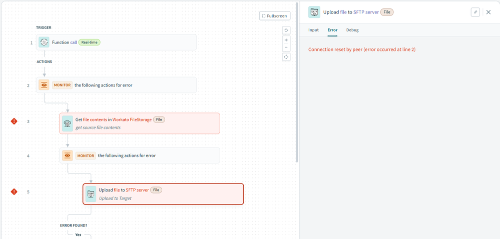

I encountered an issue while sending a .zip file to the target SFTP. To explain the scenario in brief, I was storing the .zip file in Workato file storage, and from there, attempting to send it to the target SFTP. However, when sending directly, I received the error "connection reset by peer".Screenshot 2025-08-12 130516.pngScreenshot 2025-08-12 130138.png

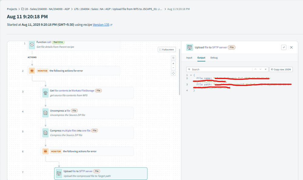

As a workaround, I chose to uncompress the file, then compress it again, and send it to the target SFTP. This approach worked, but significantly increased my task consumption.

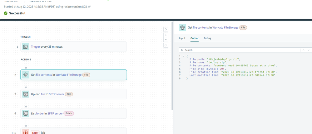

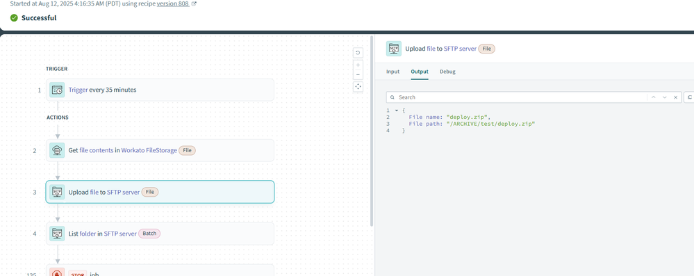

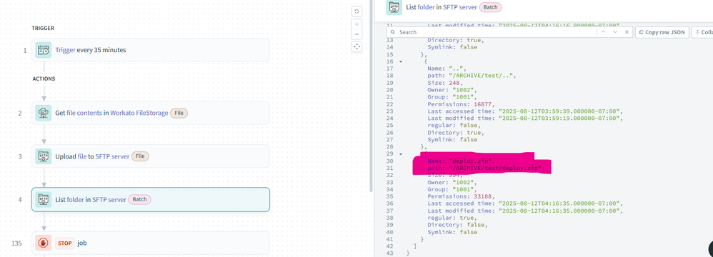

I tested with both .csv and .zip files, and I was able to upload them successfully to the target SFTP folder. Please refer to the screenshots below, and if needed, we can discuss this further.checking whether file exists or notchecking whether file exists or notupload into SFTPupload into SFTPGet ZIP File from File storageGet ZIP File from File storage
Even I have tried with reading file from one SFTP and loading into another SFTP as well.

Yes, @dinesh_c, I have created a zip file and uploaded it to file storage from the local system itself. However, I have even tried reading the file from SFTP directly and loading it into another SFTP; in that case, it worked fine for me. Also will you check with a smaller zip file rather than a larger size file once?
