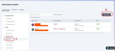

โ05-06-2026 11:02 PM - edited โ05-06-2026 11:03 PM
I am trying to login to workato go but unable to login , its a trail account i have and when i use the subdomain provided on workato ai dashboard hub it asks for login , i used the same trail account credentials but its throwing invalid email password error

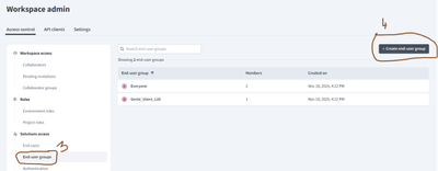

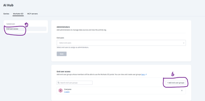

Hi @chandansharma10,
Yes, first we need to create a login credentials for the Workato Go to login, for that you need to add your email in the End-User section in Workspace Admin, after that you will receive an email, by following that you need to create a password, next you need to create a End-User Group in the workspace admin itself and add the email (user) to the group, after that in the AI Hub section --> Workato Go --> End user access --> add the Groups which were created in the Workspace admin section. now access the domain url in the browser, when asks for login provide the email and password, you are able to access it. Hope you got it?
