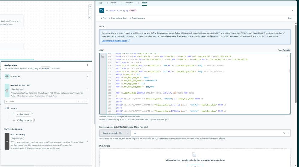

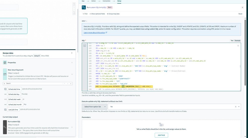

05-29-2025 01:44 PM - edited 05-29-2025 01:52 PM
In the images below, the 2nd image shows I can pull the Last Job Time from the recipe properties. In the 1st image you will see when I create the recipe as a Function Call, I do not have the data pill available.
05-29-2025 01:49 PM - edited 05-29-2025 01:50 PM
That's an easy fix then! Simply don't use that data pill and log your actual last job time elsewhere instead.
You can create a lookup table in Workato and manually enter the last job time to get things started. Update your recipe so it queries the LUT to get the time, and then you can write the new time at the beginning or end of your recipe (your choice, maybe write it after it completes successfully).
