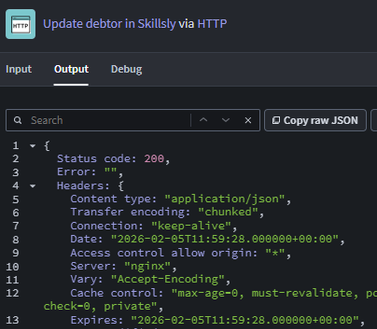

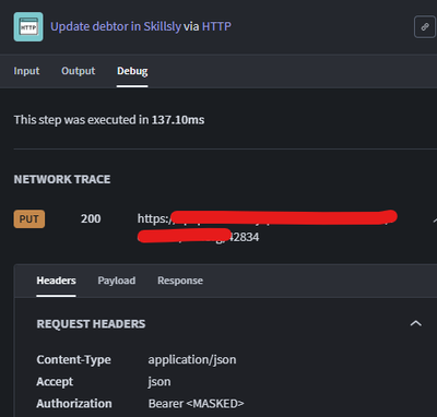

Hi, when reaching out to an application with the HTTP connector I often get an error for "invalid_token, the access token provided has expired". This seems to happen every time a new token is needed for a call. When repeating the job, the call goes just fine.
First call result:
Schermafbeelding 2026-02-05 124927.pngSchermafbeelding 2026-02-05 131738.png

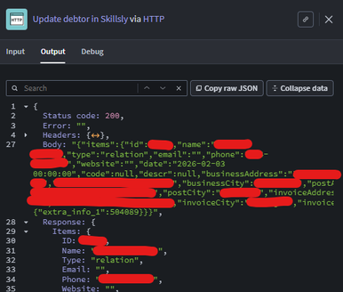

Second call result:

In the debug of the HTTP request I see no details of the actual headers/payload/response

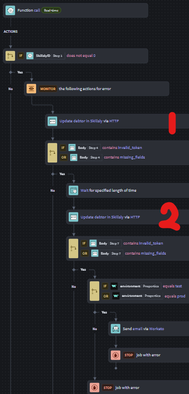

So now I put in an IF statement, and then put a WAIT block for 5 seconds, to retry again.. which also has an IF statement to alert if the response is the same.
Do you consider this a proper work-around? The recipe looks like this:

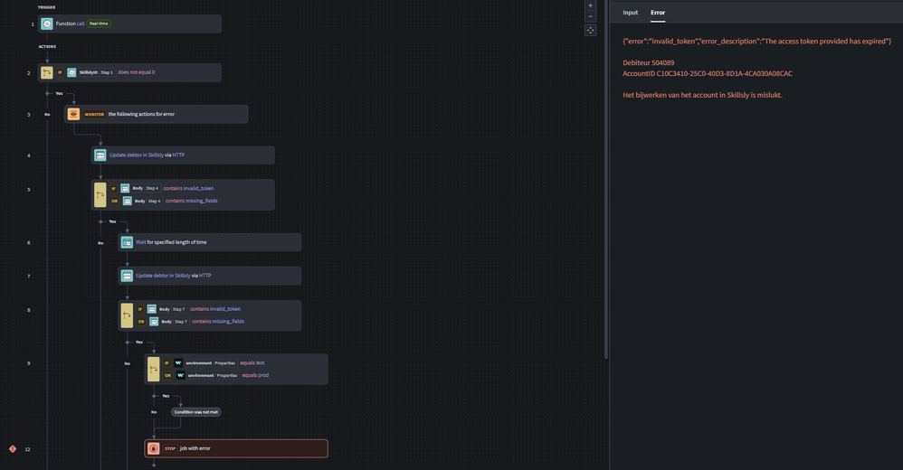

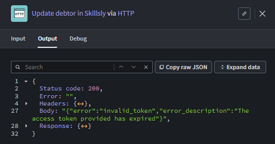

Hi @francbaviello , I just retried and noticed even this workaround is not proof.. there was still an invalid_token error:
The wait specified length of time is set to 5 seconds, but this does not seem to be enough either.
I might have to check your manual Oauth token management or  hope you guys have another way.
