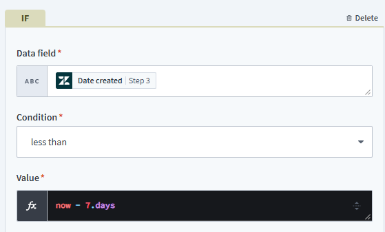

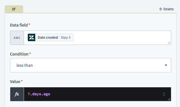

I'm compiling a condition whereby the Date Created will have to be over 7 days old. Running into issues with the condition itself. Can someone have a look, please? I bet it's eay and I am just overthinking:
tried this as well:

Hi @Sonia , Date created value's is a the time the user was created.
The first condition (< 7.days.ago) is formally correct, but probably the field Date created is not a DateTime.
So, you can set 'Date created' with the function .to_time to convert data to an ISO time stamp.
Example: you can create a Variables with "type": "boolean" and set the formulas with this value: Date Created.to_time < 7.days.ago
After you can check the Variables boolean with true or false condition.

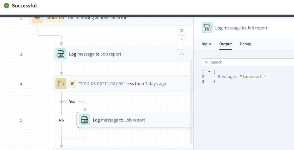

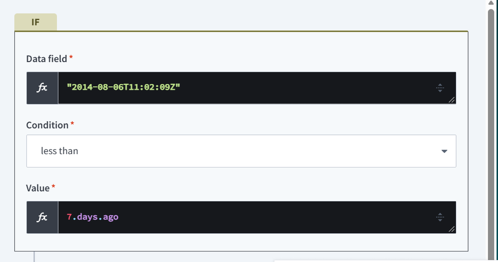

Hi @Sonia ,
If possible, can you send us what is the response when log " Date Created" field from Zendesk
But here I am adding my view on this, here I am adding screenshot
Assuming Zendesk date created is of type format: "2014-08-06T11:02:09Z"
