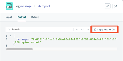

Hey @runelynx , could you share the raw JSON response using the "Copy Raw JSON" button?
If the response has a fixed schema, it shouldn’t be difficult to retrieve the specific field you need without using Ruby code.
