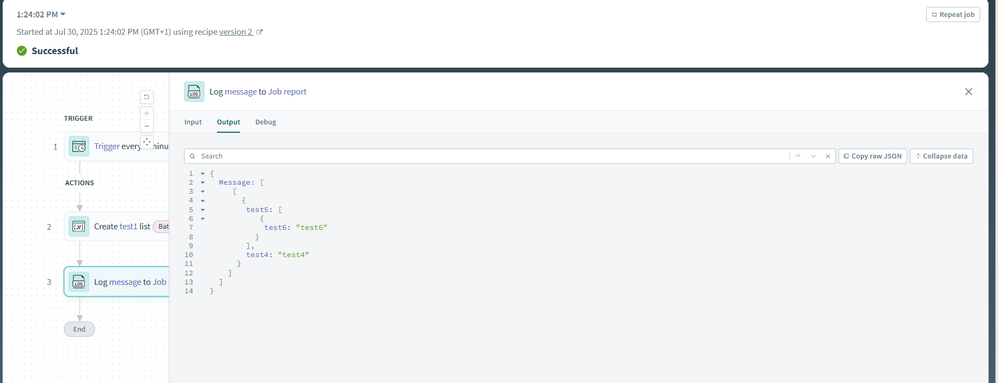

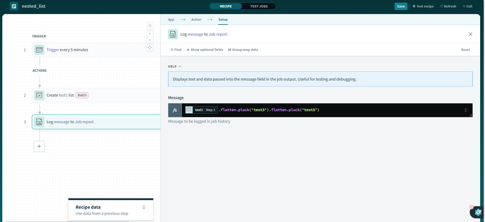

โ07-30-2025 05:31 AM
Hi,
To get values from nested list we can use formula mode and try in this way flatten.pluck('List_name').flatten.pluck('list_name) pattern . So we can get all nested values in this method
Attached the working method in screenshot .please refer once
Thankyou

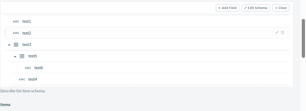

This is structure i have defined for nested lists
Formula implemented to get nested list
output for nested list 1

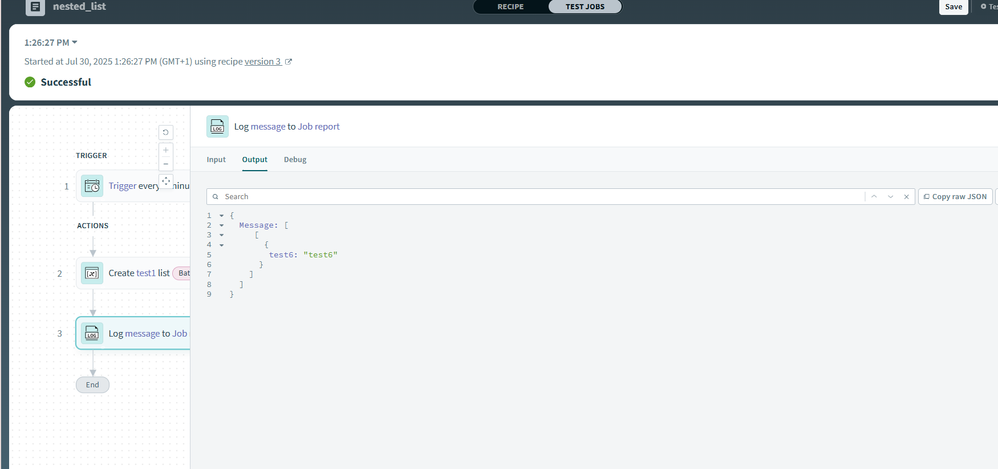

tried to pluck another nested list
Output for nested list 2
