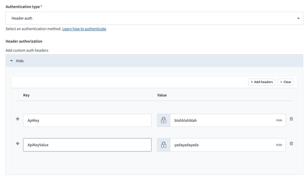

I have an HTTP Connection that I set up that uses headers for authorization.
The problem is that only the first key is being passed with the request.

I made this connection and tested it:

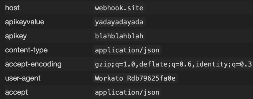

Here's the receipt of the request. You'll notice the API headers are downcased. I figured this might be part of the UI of site, so I tried several other similar tools (hooklistener.com, usewebhook.com, play.svix.com) and they all have the same shortcoming -- all of these sites either upcase or downcase the headers before presenting it in the UI. Great.
So, after all this, we're at least sure both headers are being passed, but we're still not sure about a couple things:
  1. Is Workato manipulating the header casing?
  2. Does your API actually have case-sensitive headers?

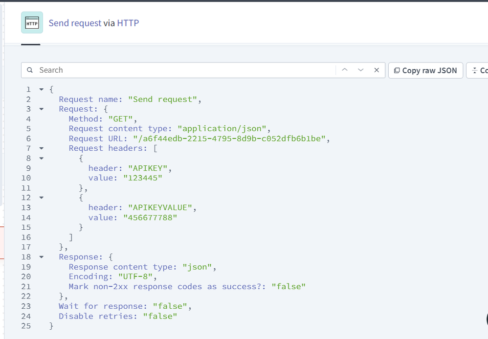

I have sent the API key and API key value directly via the recipe, as we are unable to verify the headers when they are sent through the connection configuration. From our observation, Workato is not modifying the headers and is sending them exactly as provided.
Please refer to the attached screenshot for reference. However, it appears that the API endpoint itself is transforming the header names (for example, converting them to lowercase).
Official standard:
RFC 7230 / RFC 9110: HTTP header field names are case‑insensitive
So when an API requires case‑sensitive headers, it usually means:
  • The API is incorrectly implemented
  • It violates HTTP standards
  • Many tools may not support it properly
