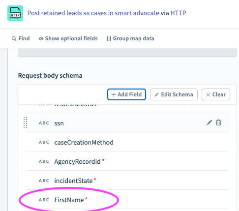

For the request I need to send a field with a field name of "First Name" so that the endpoint of the request can process it. "First Name" with a space is what the logic of the endpoint is expecting. However, Workato's HTTP request does not accommodate sending the name with a space. Instead it supports "FirstName" and "First_Name". When I use "FirstName" the field name of the request body schema  (image attached) Request body using "FirstName"Request body using "FirstName"in Workato's HTTP appears to separate the First from Name (see image) Screen Shot 2023-10-18 at 8.09.21 AM.pngin the input field name but when received at the webhook endpoint the name appears as "FirstName". Your solution would work if I controlled the logic at the receiving end but I do not and am trying to conform to the endpoint's standard.

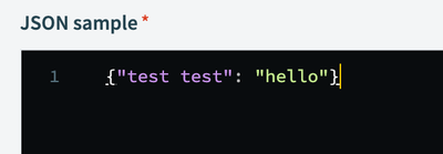

If you create the request body by providing a JSON sample, you can bypass this blocker. I tested this out using a recipe with an HTTP action using a multi-part form to make a POST call to an API endpoint, and then reviewing how the payload was received.

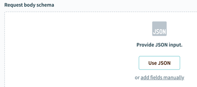

First, on the request body schema of the HTTP action I clicked "Use JSON" and to provide an example of how I want my payload to be structured:
I entered this:

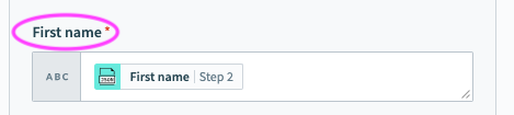

It created this, which is misleading because it added the underscore to the label:

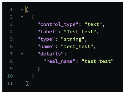

However, if you look at the schema, it has a details.real_name value of "test test" which is actually how the field gets encoded and sent in the API call:

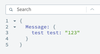

Next I made an API call to an internal endpoint (with a value of "123").

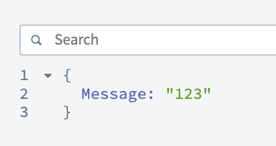

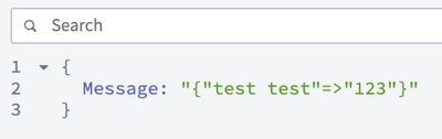

I logged the message three different ways to be absolutely certain it was retaining the space:
To JSON:
To string:
Raw:

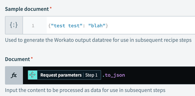

And then I even threw it into the JSON parser to ensure it parsed correctly:
And it did:
