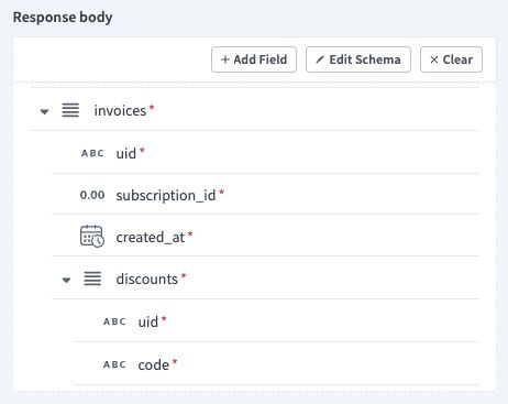

Iโm making an API call that returns an array of invoices. Nested inside each invoice is an array of discounts. Hereโs a screengrab of the (cut down) Response Body for the step so you can visualise the structureโฆ

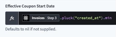

Itโs a snap (as US folks would say) to return the minimum created_at date from the invoices arrayโฆ
โฆ and this works as expected. Itโs just that I want to return the minimum created_at date value from invoices which match a specific discount code value.
Feels like I need to use โwhereโ but I canโt figure out how to refer to nested array fields in the where clause. I'm after something like...
where("invoices.discounts.code" = myvalue)
I know how to use nested array values for "pluck", but can't see how the syntax works with "where".
What am I missing...?

Unfortunately this isn't possible using where. You can either use a bunch of loops, or you can dump it into a Ruby action and solve it quickly with .map or .select. I tried a few science projects to do it inline, but nothing was as efficient or convenient as a simple Ruby action.
