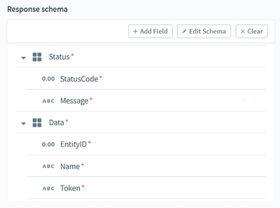

Response Schema:

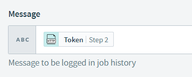

โ€ƒLogger Message:

@rlymer can you show the configuration of your HTTP connector? Make sure the "Response Content Type" is set to JSON. Based on your screenshot, it appears the response is being interpreted as text.
Turns out I was using the v1 API for this system that only returned text output. The v2 API returned JSON when I used it.

Hi @rlymer ,
can see that your token follows the hierarchy below.
Status --> Data--> Token (Please let me know if my interpretation is incorrect).
Because of this, if you specify the token directly, it will not be displayed in the logger; instead, use the "pluck"  formula to fetch the token. Please let me know if that works for you; otherwise, we can connect.

Pluck isn't needed here. The response is being interpreted as text, but it should be parsed as JSON.
In the example, Status and Data are on the same level. Data is not within Status.
