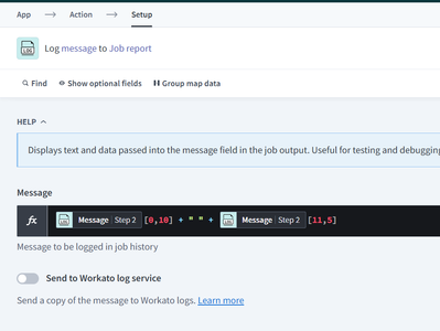

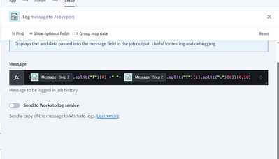

Hi @Sonia,
Yes, I too getting errors with strftime and .to_date and .to_time formula, but we need to walk through some work around solution with formula. but for instant thought, please check the below solutions.
