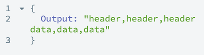

You can only use drop on an array, so first split your CSV on line breaks, then drop, then join it back together with line breaks.
Heads up: if your data contains line breaks, this will also replace them. If that's a problem, there are other ways to do this.

Thanks Gary! Will give this a try and report back.
OK so for the record, my biggest problem in all of this (not mentioned originally because I was unaware) is that I *thought* I was downloading a CSV from Google Drive... but turns out I was downloading a Sheet ๐Ÿ˜…
Thanks Gary for your answer. I had to prepend a .to_s method since the [File contents] data pill is not a string (despite appearing that way in the data tree), then worked like a charm!
