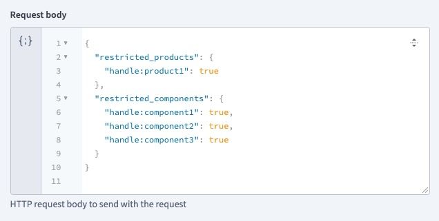

When using the Guided Setup and supplying sample JSON for the Request Body like this...
... Workato correctly passes the data onto the Target system which takes the necessary action.  So I know the JSON being passed in the intial setup is correct.

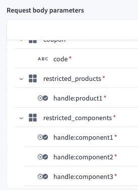

But then when I inspect the resulting Custom Action step in my Recipe, Workato has decided that the constituent product and component items which make up each of the arrays are fixed values.  The Request Body Parameters portion of the action looks like this...
But the number and names of each product and component will vary each time.
How do I tell Workato that restricted_products are restricted_components are dynamic arrays, and pass in appropriate values?

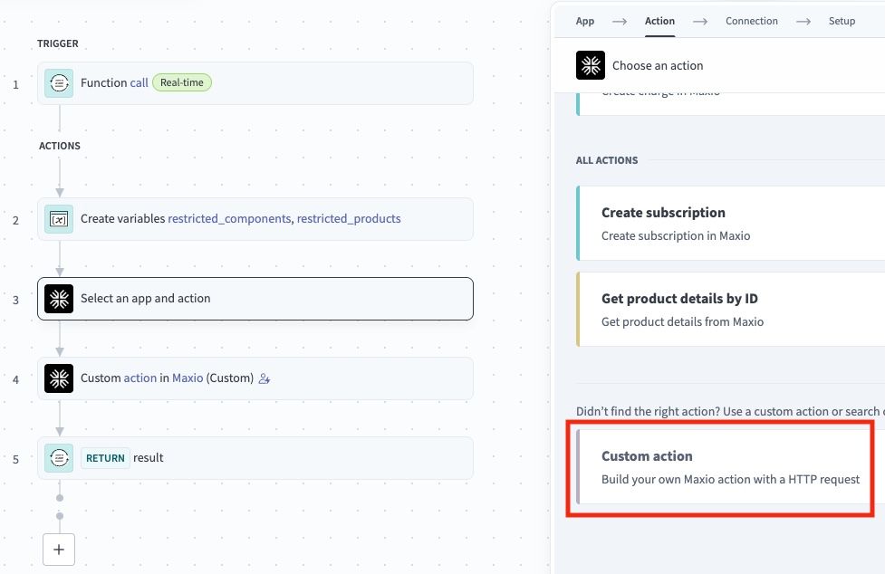

Secondly (and this might be key to my confusion), I donโ€™t follow your statement โ€œyouโ€™re making a custom connectorโ€.  Iโ€™m not building a customer connector, but just using the OOTB Maxio Connector and using the Guided Setup to build a Custom *Action* (using a sample request)...?
So whilst Iโ€™m sure youโ€™re making a valuable point about passing โ€œthe data into the connector in whatever format you want and let the connector construct the API call internallyโ€ I think you may be assuming too much about where Iโ€™m starting from?
