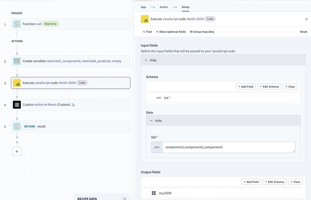

My recipe is effectively just two blocks - one with the JS and another to execute the Custom Action.
The JS block takes a "list" input field which contains the comma separated list. The JS (thanks ChatGPT) turns the list into a suitably formatted object which is output in the "myJSON" field...

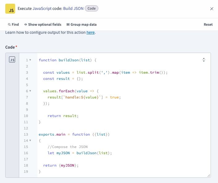

Here's the code for reference...

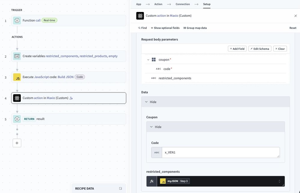

The myJSON output is then slotted into the custom action block like so...

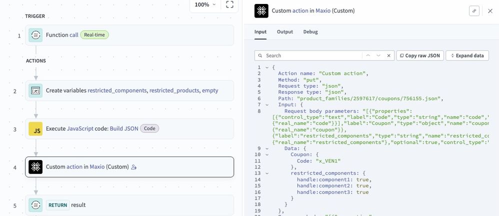

I think the only problem is that, when run, the name and values (e.g. handle:component1) are not "quoted". Here's the result of running the job...
Whilst the target system (Maxio) does not choke on this, it also doesn't do what I want, so think it's just ignoring it.
