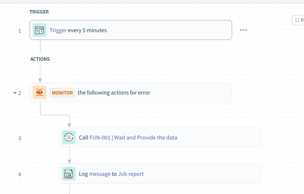

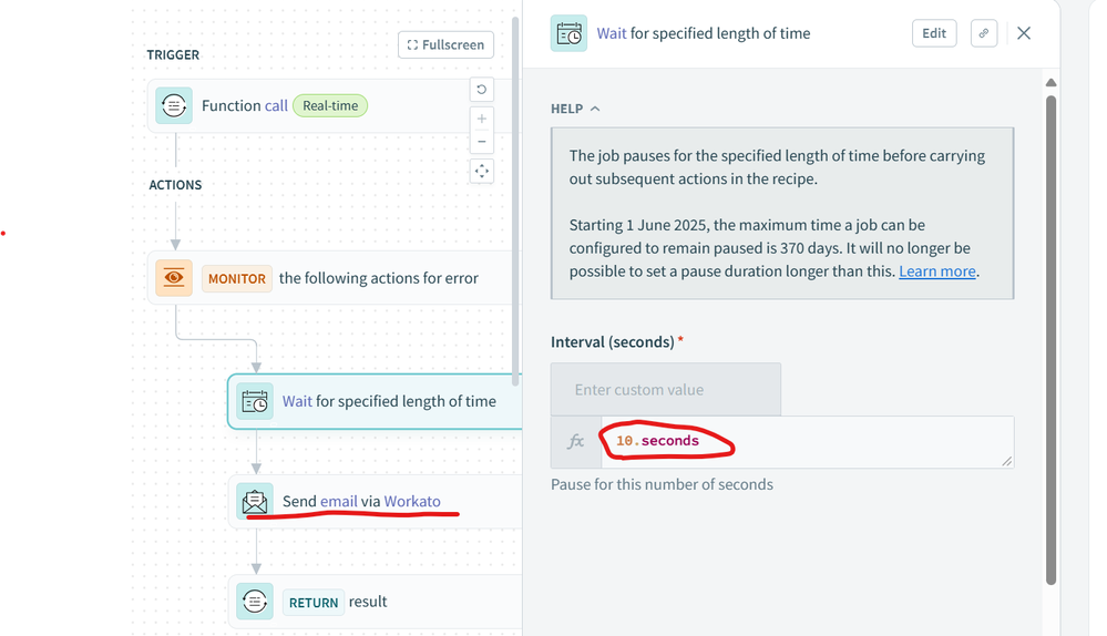

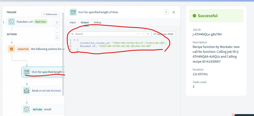

Hi @philSch ,
Here I am adding screenshots, which I tried as per the requirement, and it is working as expected.
Please kindly start the recipe instead "test the recipe option".
to answer your question:  Can this be related to the time zone ? No, I am running the recipe in the default time-zone i.e. PST
