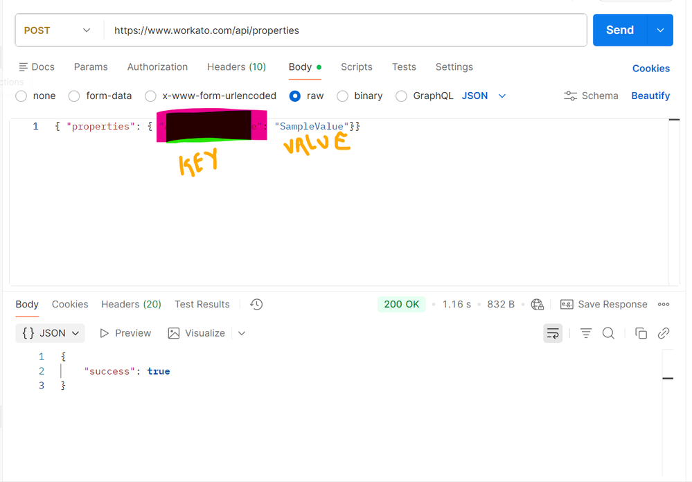

Hi @mahlon ,
Please kindly confirm from your end whether you have access to perform updates via the API. Due to RBAC (Role-Based Access Control) restrictions in Workato, it’s possible that update permissions may not be granted.
Please check whether you have access to the Developer API for the collaborator role that has been assigned to you.
