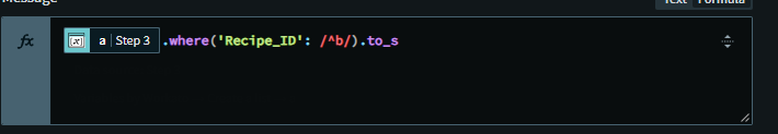

Hello everyone
I have a question about the lookup tables。I want use formula in column。
I want to find a data start with “B”, How to write the formula in column?

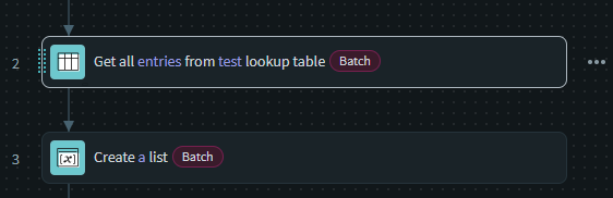

Dear, @FrankXu
You should add two following actions
Then, you can add the formula in input field you want (maybe leave to.s function).
