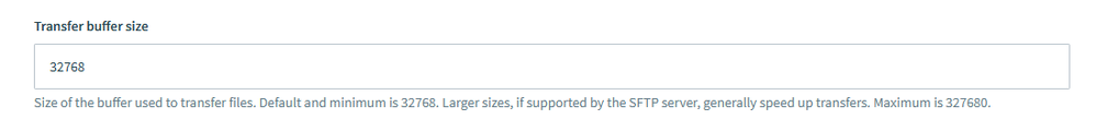

โ11-10-2025 10:59 PM
Try increasing the Transfer Buffer size in the SFTP connection settings
