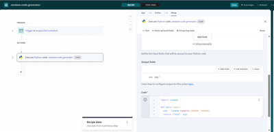

Hi @shaked,

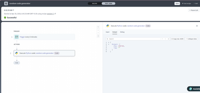

I believe there is no way to generate a code with any FORMULA, we need to go with any scripting (Python, Ruby, JS). Please check the below output which i got from Python code.
import random
def main(input):
otp = random.randint(100000, 999999)
return {"otp": otp}Thanks,
