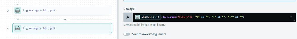

I am assuming that your output is coming as -
"message": [
"sample@email.com",
"sample2@email.com",
"sample3@email.com"
The result you are expecting is - to map to your target field which accepts the multiple email address in the string format.
"message": "sample@email.com, sample2@email.com, sample3@email.com"
for this to achieve:
=.to_s.gsub(/[\[\]\"]/, "[" => "", "]" => "", "\"" => "")by using the above formula you can easily convert the array of emails/strings into a single string with the comma separated values and map to the target step.
If this doesn't solve you problem let me know with the actual schema and the result schema that you are expecting.
