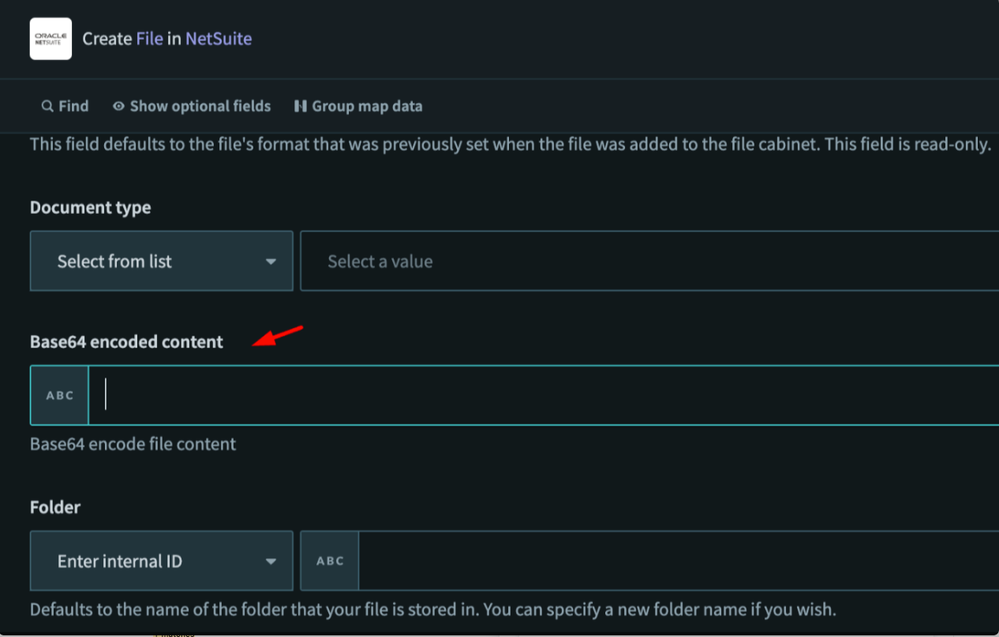

I am trying to upload file to Netsuite file cabinet through Workato connector - Netsuite SOAP. When running the recipe, I am getting error - "You must upload a file before creating this media item". I tried using "Create Standard Record" action and also 'Upsert Standard Record" but it didn't work. Can I get some pointers to resolve this?

Hello, it could be the file content of the source file is not in Base64. NetSuite expects Base64 format. Encoding to Base64 should fix the issue. Please see below:
