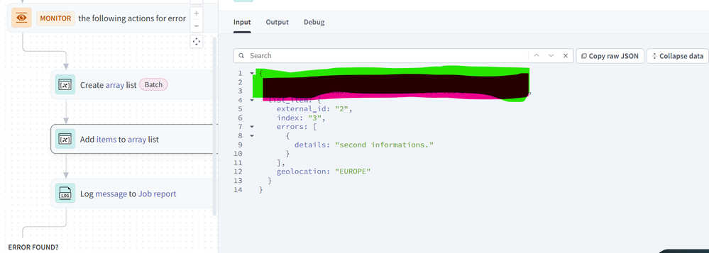

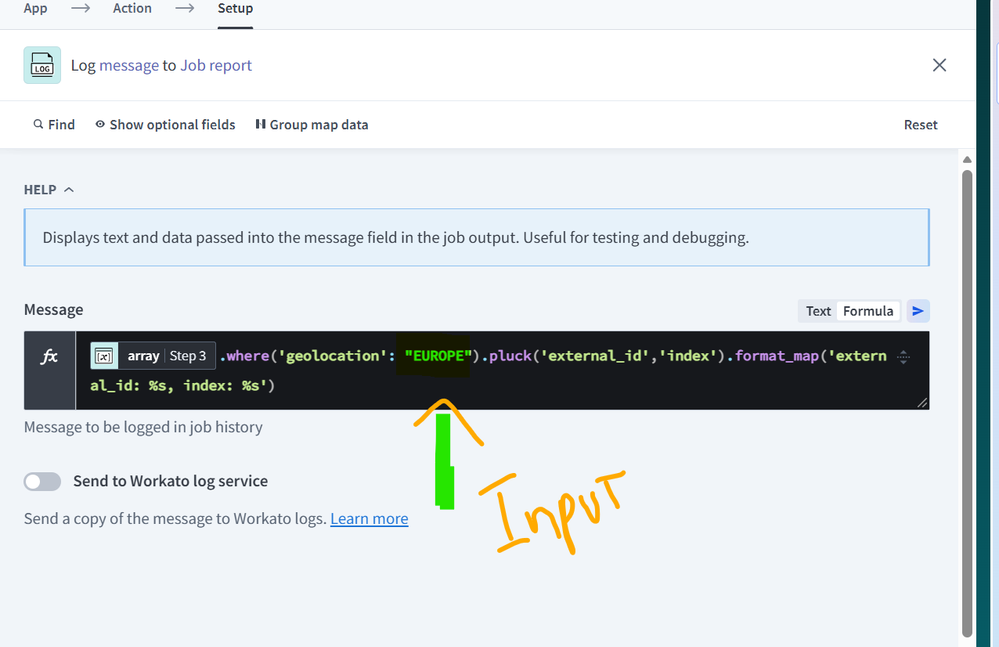

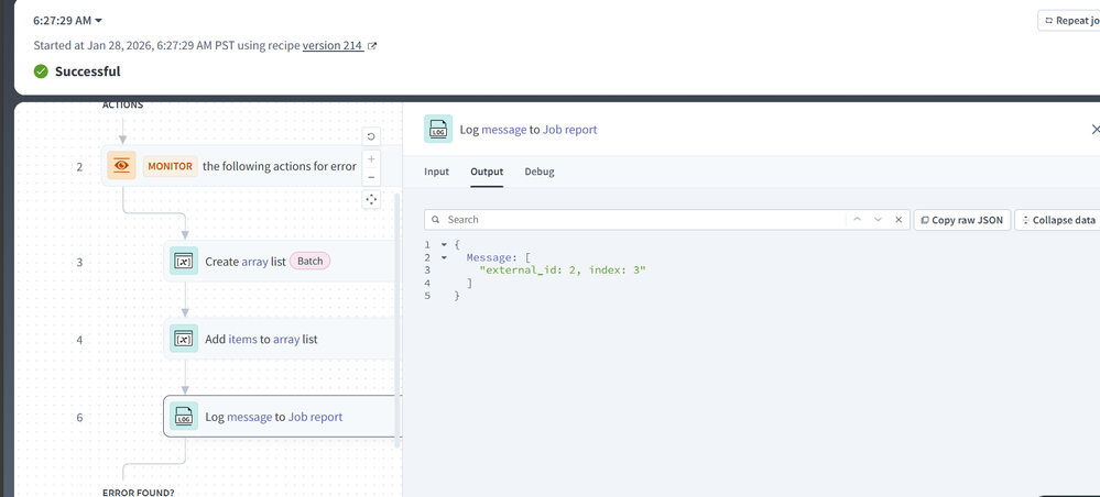

Hi @Buvi , you can use the function 'where' and 'pluck'. example of formula:
array.where(Job profile comp band: 'Sr.Manager Testing').pluck('Employee name')
tell me if you encounter any problems
