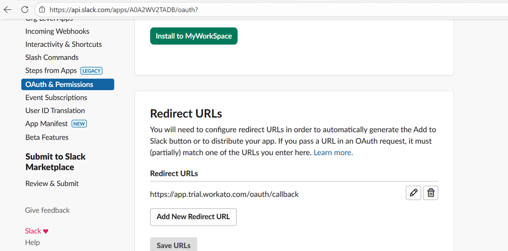

Hello @jhahn ,
I hope you’ve created a custom OAuth profile. If it’s already done, make sure that the profile is assigned while establishing the Slack connection that should prevent this issue.
If the issue still persists even after that, please verify whether the trial URL is added as a redirect URL. If not, kindly configure it in your slack app as shown in the image below.
Please let me know if you need any help with this.Screenshot 2025-12-11 204359.png
