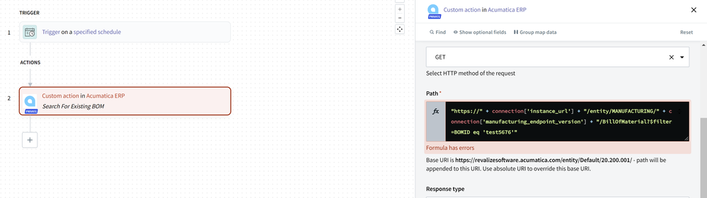

Is it possible to access connector properties using formula ? I'm using custom action where I need to define the full URL rather then just the path, however most of the details I need are already populated during the initial connector setup. can you access these from formula rather then hardcoding the full URL in the recipe?
Id prefer not to rework the existing connector to change the existing base_uri / all of the existing actions.

I this case the base URI of the connector is:
https://revalizesoftware.com/entity/Default/20.200.001/
Any other value I enter will get appended to this URL as part of the path, unless i specify an absolute URL. In this case i need to override more of the URL then just append to the existing base.
Entering "MANUFACTURING/21.200.001/BillOfMaterial" in the path I would end up with:
https://revalizesoftware.com/entity/Default/20.200.001/MANUFACTURING/21.200.001/BillOfMaterial
I need:
https://revalizesoftware.com/entity/MANUFACTURING/21.200.001/BillOfMaterial
So I am looking for a way to use formula to do this (as all the fields i need are already entered as part of the connection) rather then rework the connector.
