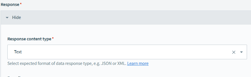

Hello, @rm135 ,
you can  do that by keeping the response format as TEXT in your HTTP step. That way, you don't need to define any schema or worry about data pills.
But since the response will be treated as a raw JSON string, you'll need to use a code step (Ruby, Python, or JavaScript) to parse that string and extract the part you need
Hope this helps! Let me know if I missed your question or if you need something different.
