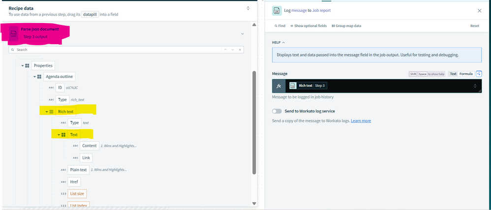

Have you tried implementing with JSON Parser (Json tools by Workato), with that you can able to access rich_text array easily. like shown in the image below. if not, please let me know the exact requirement, will look into it.

Have you tried using the json parser that will give you the  data pills of the json and you can select the required data pill to print the message.
