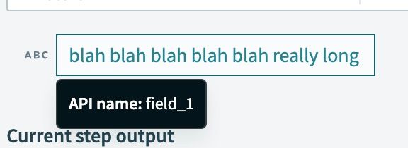

When you use .pluck you need to refer to a data pill by its "API key", which is the schema key and NOT it's readable label. This usually trips people up when using methods on connector data pills with really long labels, or when the label and the key are completely different.
To see the API key, just hover over the data pill. If you were to pluck the pill below, you would use .pluck("field_1") and not .pluck("blah blah blah...")
I'm mentioning this because you might have to pluck "Price list 2 of price book ID 18 char c" and I would be very surprised if that label was also the API key.
