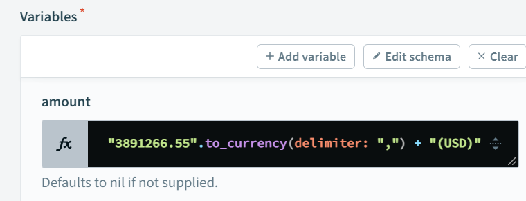

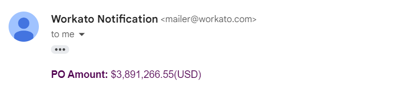

Hi @johnw ,
Try with below formulae. Hopefully it solve your problem.
Just add the data pill in HTML body.
<strong>PO Amount: </strong>   $<Amount Data Pill><br/>
@gary1 ,
You were right, but we need to modify little bit based on the Ask.
Thanks and Regards,
