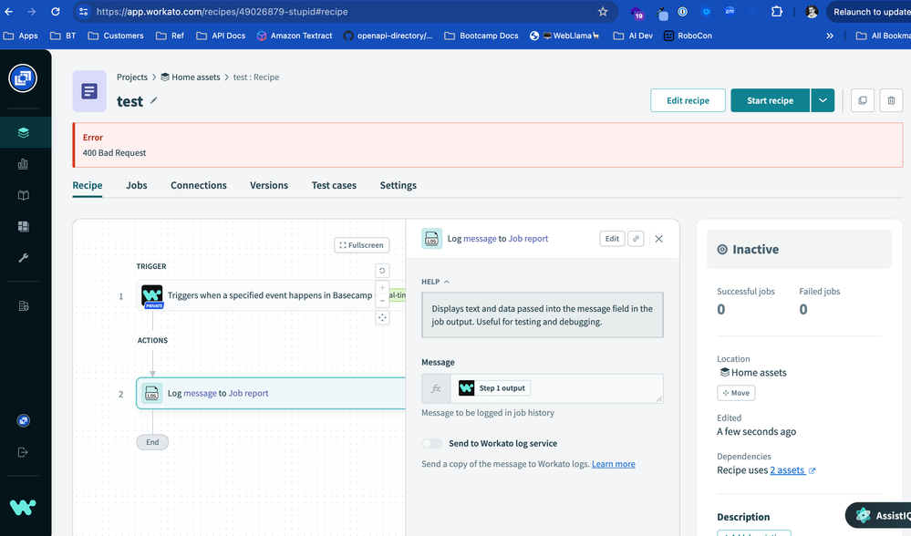

Hi Friends — I need some help with the new_event trigger in this custom connector. The trigger passes validation & testing done via the SDK development screen, but it throws a 400 error if I try to start a recipe with it.
Below are some screenshots and the code for the custom connector. API documentation here.
Is there any way for me to see the HTTP request Workato is making when I the trigger is executed? Any tips or words of encouragement appreciated 😅

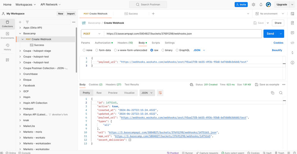

Successful Test in Postman:

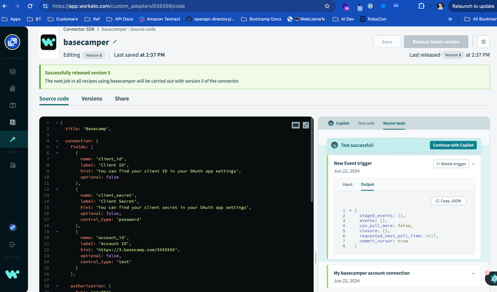

Successful Test in Workato:
Failed Recipe:

06-22-2024 05:01 PM - edited 06-22-2024 05:02 PM
omg nvm I got it sorted. Here is the corrected triggers block, for anyone interested:
