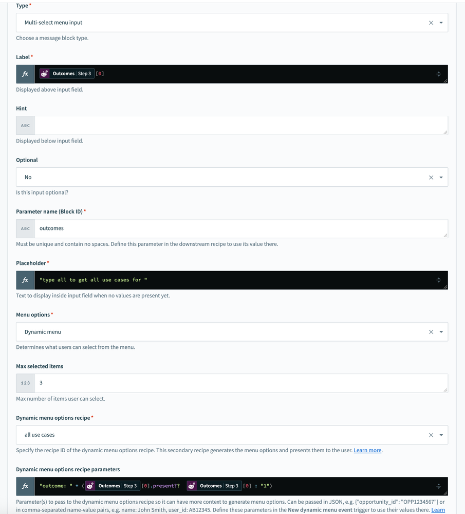

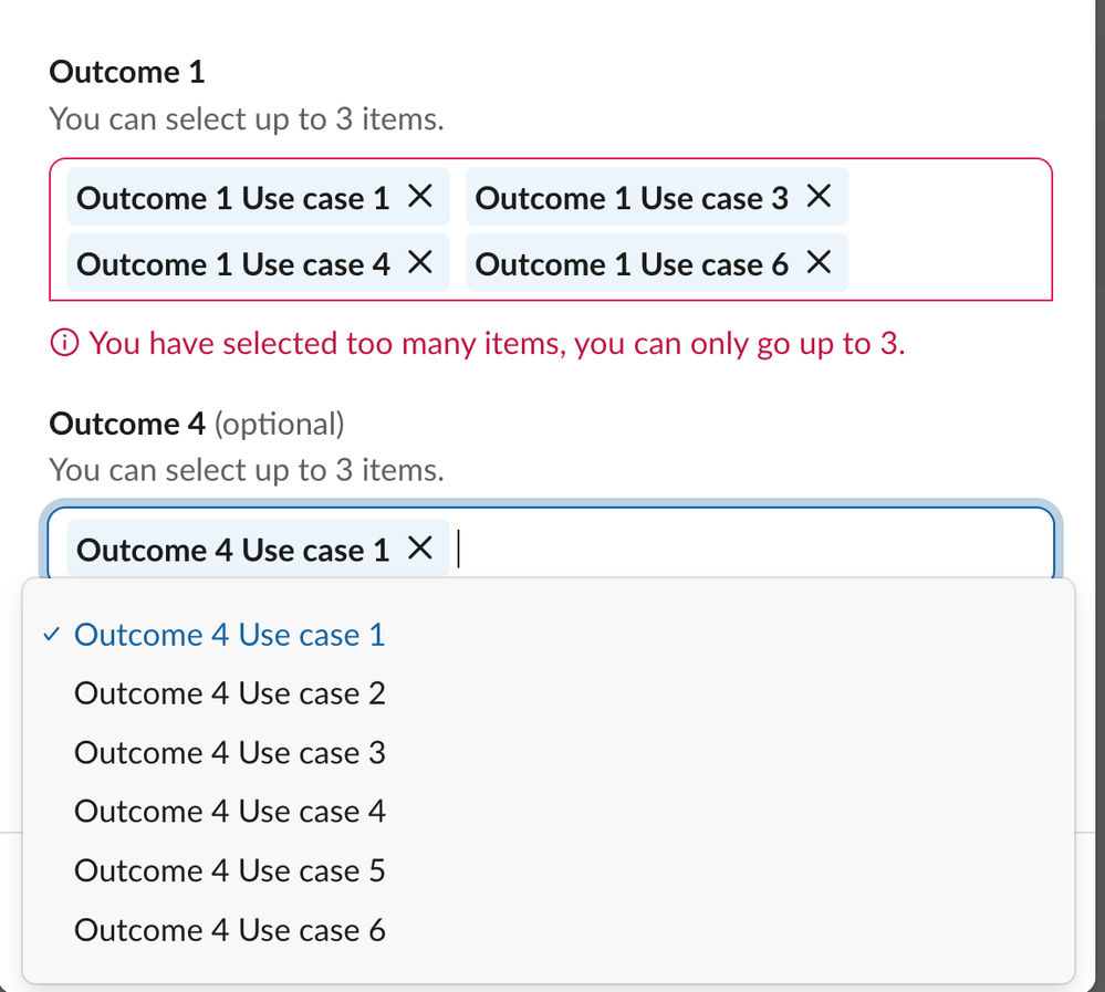

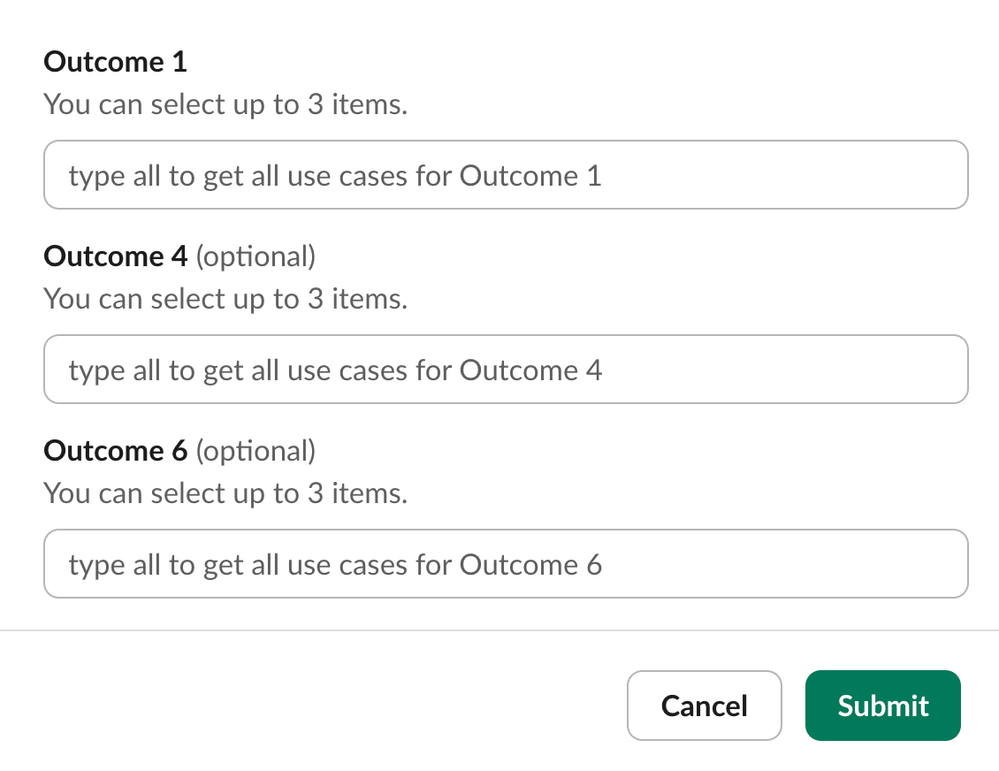

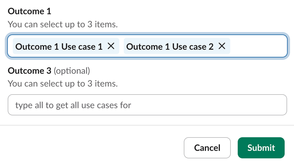

  1. When You Have a Condition to Select a Maximum of 3 (Simpler Approach):
    • In this scenario, after getting multiple selections from the first modal, you can call a second modal with 3 multi-select blocks, as shown in the screenshot below.
    • Simply create a dynamic menu recipe to get the use cases by passing outcomes as parameters.
    • If you select two values in the first modal, only two will be displayed in the second modal.
      Screen Shot 2025-05-22 at 16.35.38 PM.pngScreen Shot 2025-05-22 at 16.24.56 PM.pngScreen Shot 2025-05-22 at 16.36.25 PM.pngScreen Shot 2025-05-22 at 16.25.27 PM.png
