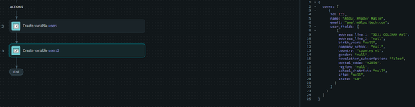

Dear, @amalim
In Workato, the except formula does not directly work on nested object like you have in the user_fields. When you're trying to remove fields from a nested object, you can't use the except formula directly on fields within that nested structure.
To handle this is to reconstruct a new variable.
