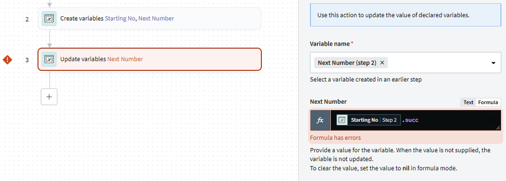

Error: I would like to get next number from "SO012501" to "SO012502"

The succ method isn't supported in the in-line Ruby (in formulas and variables), but it is supported in the Ruby action.
Create a Ruby action with an input called "str" and and output called "result" and then use this code snippet:
{result: input["str"].succ}

Workato does not support the "succ" formula for generating successors. To achieve this functionality, you can use Ruby, Python, or JavaScript to manipulate the data. If you need further details or assistance, feel free to reach out!
