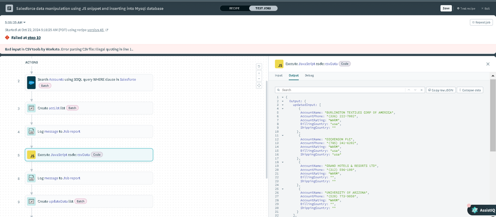

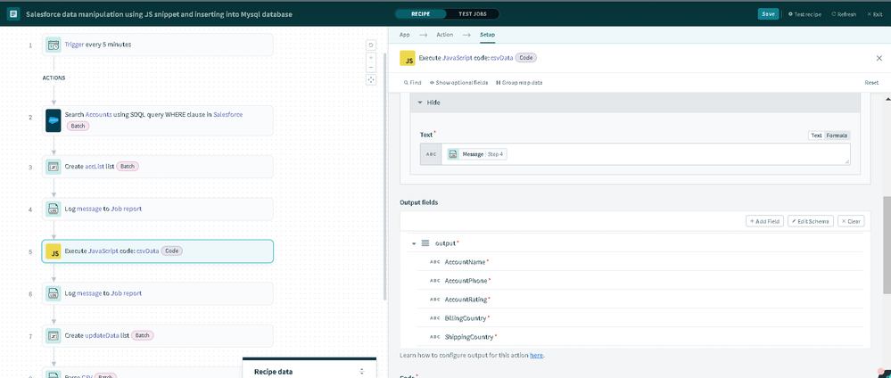

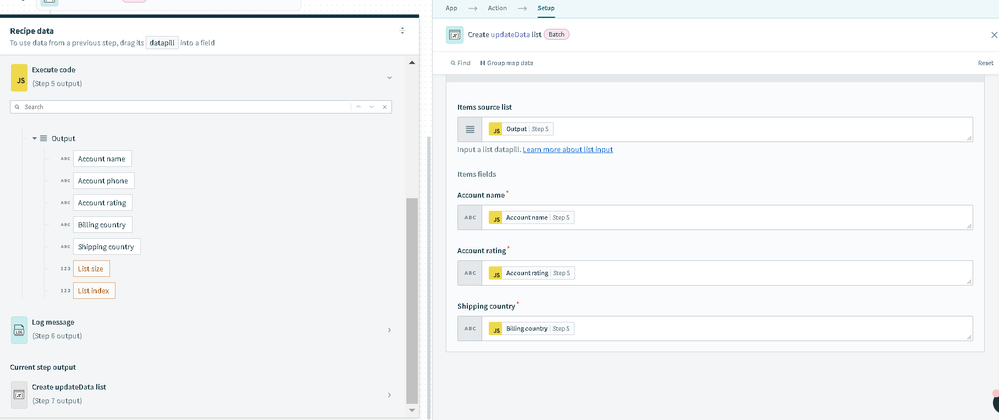

Hi guys, i want help today i created one recipe using JS snippet by workato in this recipe i get the data from Salesforce and by using JS connector i did the Data Transformation , in this JS connector i defined the schema for input and output field but whenver i am trying to create a list by using variable by workato and maapind the datapill i'm getting empty array no value is coming , i don't know how to provide the value to output field which one is defined in output schema.

output from js snippet - output from JS Snippet  this is output & input Schema for JS Snippet :-
output schema
input schema
creating List and mapping data but not getting any value :-
list creation
output getting empty
i'm trying to map with output schema but not getting any value.

On the JS connector output schema the output is named "output", but in your code the output is named "updatedInput". They need to match.
