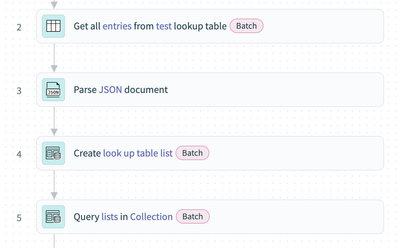

  • Use the Lookup Table action to get the whole table

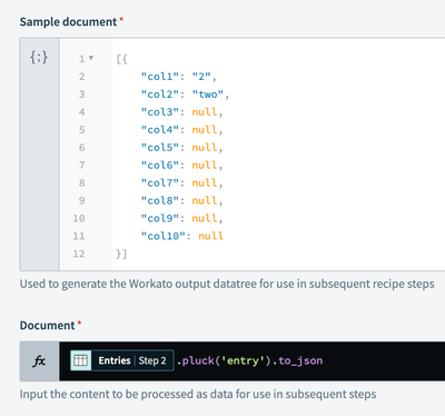

  • Add a JSON parser with this as the schema (you could adjust the data types as needed, but prob not necessary)
	"col1": "2",
	"col2": "two",
	"col3": null,
	"col4": null,
	"col5": null,
	"col6": null,
	"col7": null,
	"col8": null,
	"col9": null,
	"col10": null
  • In the JSON parser document field, enter this in formula mode: [entries datapill].pluck('entry').to_json

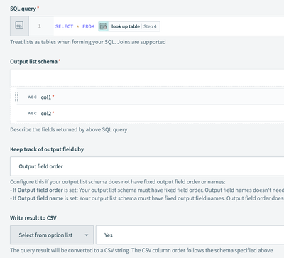

  • Add a SQL Collection action and use the "Array" output list from the JSON parser as input
  • Query the Collection
It should look like this:
JSON parser:
Query:

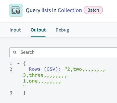

Query output (as CSV):
