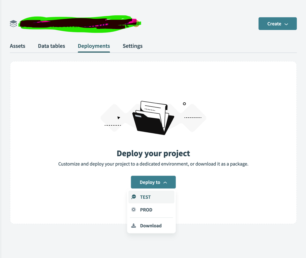

Hi @Patel0786 ,
One more way of doing it using "Deployment" ( I am assuming here that other workspace is Test or PROD),
Note: If your Organization has chosen this subscription, the deployment option is accessible.
1.Sign in to your WDeployment.pngorkato account.
2 Navigate to the main DEV environment.
3 Open the project you plan to deploy and click the Deployments tab.
4 Click Deploy to. The following options appear in the dropdown:
     TEST
    PROD
