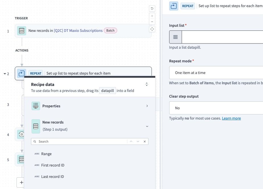

So I assumed I would simply return to my first recipe and change the trigger from the (single) "New Record in Data Table" to "New Records in Data Table (batch)" and then use a For Each loop to process the new records.
Except, when I go to the Repeat step and click in the Input List field and browse the output from the trigger step, I can't see a handy array of Records to loop through.
What fundamental principle have I failed to grasp?  And is there a better way to do what I'm trying to do?

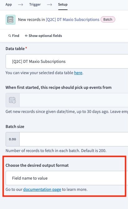

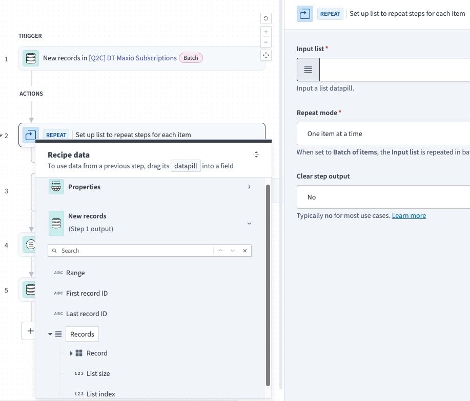

Hmmm... looks like I had failed to specify an option for the "Choose the desired output format" field on the trigger!
This was initially left blank when the trigger was changed.  When I chose (either) value from the drop-down I can now see the expected records array/list...
