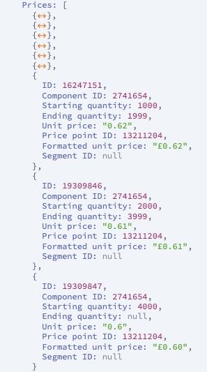

Sample JSON of the array of Prices looks like this..

Appreciate your time (as always) and confirmation that there's nothing readily apparent as an alternative besides writing a code block.
