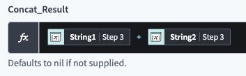

I often find I want to concatenate two or more strings together, usually when trying to formulate a friendly error message for a log or an email to a human when something's not quite worked right.
However, you can't safely just use...
... because if either or both values contains a NULL, Workato throws an error.

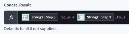

I started to head down the ternary operator route (which felt overly complicated and difficult to read) and then stumbled across the use of ".to_s" for each data pill to force convert the data pill to a string...
Now, if either value contains NULL the result is an empty string (which Workato is then happy to "squish" with another string).
