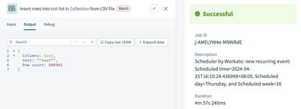

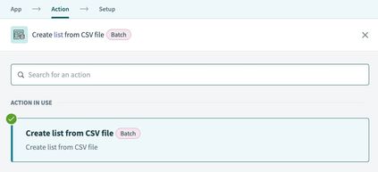

Hi, everyone!
To handle CSVs with more than 50K rows, we suggest using the "Create list from CSV File" action via SQL Collection. It does not have a hard limit but will follow the platform-wide job timeout limit.
Here's a test on a CSV with 500k rows :
2 weeks ago
This is the better option instead of chunking the file.
